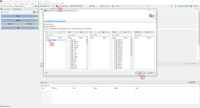

I am using FreeRTOS with S32K396 development package. I was getting OS option under S32DS to configure RTOS related parameters.
After recent update, OS Option is missing from above menu.
I have recently updated my S32K396 Development package with March 2023 release. I no longer get option to configure FreeRTOS under same menu. I do not see option to add FreeRTOS through SDK. Following are details of my S32K396 package version number. Can you please help me to get FreeRTOS configuration option under S32DS.

Hi @jigs123
If you have already installed the lasted FreeRTOS release for S32K3 platforms, you can add it on ConfigTools at Manage SDK Components (please refer to the below image).
Whit this, you will be able to add FreeRTOS to your project.
