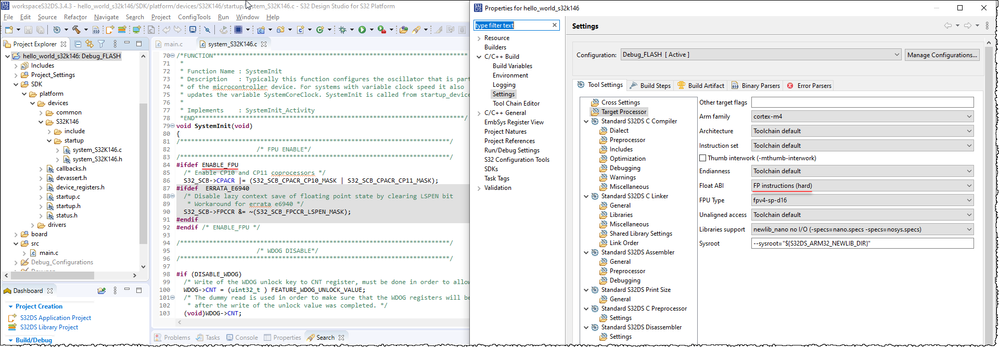

We have code running on the the s32k1SIC evaluation board, which uses the s32k146 processor. The code is bogging down in floating point math, and looking at the disassembled code, I see that it is not using floating point instructions. Looking at the manual for the processor, I see that the s32k14x processors have a math coprocessor. I tried writing a vadd instruction, and when it compiles, it tells me that I can't use floating point instructions in thumb mode. So I put in a .arm directing to generate regular arm instructions, and it tells me that I can't do that on a thumb-only processor. How can I use the floating point instructions?

Robin_Shen
Did your project enable the hardware FPU?

KelvinSmith
Thanks Robin,
I looked for a setting like that and couldn't find it. But there must still be some setting because now when I build, during the link I get errors like this for each file:
c:/nxp/s32ds.3.4/s32ds/build_tools/gcc_b1620/gcc-6.3-arm32-eabi/bin/../lib/gcc/arm-none-eabi/6.3.1/../../../../arm-none-eabi/bin/real-ld.exe: error: libuavcanV1_demo.elf uses VFP register arguments, ./Project_Settings/Startup_Code/system_S32K146.o does not
c:/nxp/s32ds.3.4/s32ds/build_tools/gcc_b1620/gcc-6.3-arm32-eabi/bin/../lib/gcc/arm-none-eabi/6.3.1/../../../../arm-none-eabi/bin/real-ld.exe: failed to merge target specific data of file ./Project_Settings/Startup_Code/system_S32K146.o

Robin_Shen
Sorry. I don't understand what do you mean: I looked for a setting like that and couldn't find it.
What IDE are you using? If you are using S32DS, then you can select Hardware FPU during create new S32DS Project too.

KelvinSmith
Robin, I see that what I said was ambiguous. I did find the option (as you described) and I selected it, matching the images above. But when I compile, at the link stage, I get the errors I listed above.
