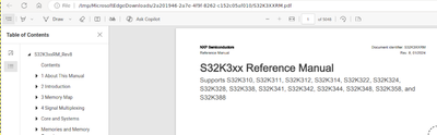

Ahelion
I do not have an attachement:
1,363 Views
PetrS
use pdf viewer that allows attachment opening. Most probably embedded viewer, or what you have, does not have that option.
BR, Petr
