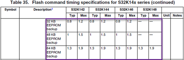

1.
The elapse time is the same in both cases.
It is the Set FlexRAM Function execution time with control code 0x00.
DS rev.13, Table 35. Flash command timing specifications for S32K14x series
2.
There is no such document.
But you can use the SetFlexRAM function with control code 0x77 to get the Sector erase count.
The counter increments every time all the sectors erased are.

Hello Jeorge,
Please refer to AN11983 Using the S32K1xx EEPROM Functionality
https://www.nxp.com/docs/en/application-note/AN11983.pdf
1.
Yes
2.
It is explained in AN11983,
Chapter 6 S32K1xx new quick write mode
3.2.1.4 FlexRAM used for querying write status on EEPROM
3.2.1.5 FlexRAM used to complete interrupted EEPROM quick write process
3.
Yes
4.
I’m not sure if I understand, can you elaborate?
5.
The levels are not specified and cannot be changed.
