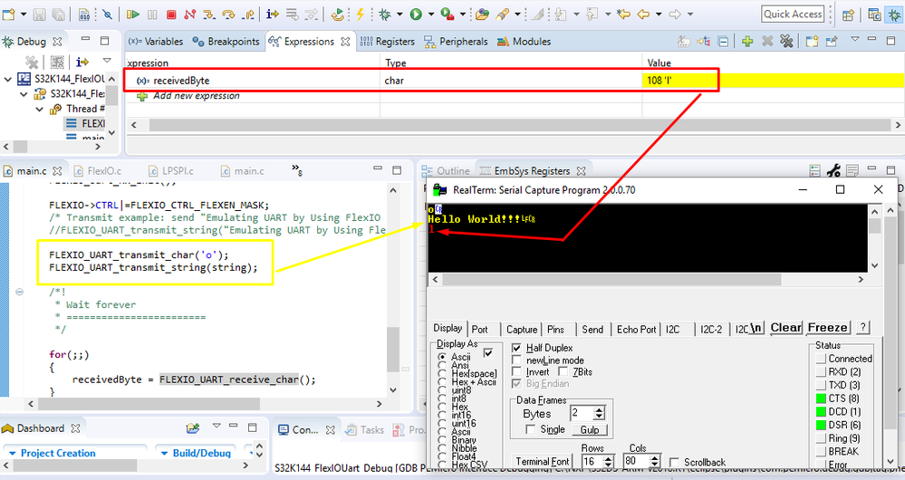

dianabatrlova
Have you tried to use the test code attached in my previous case "S32K144_FlexIOUart.zip"? There is a possibility that you are using the wrong code (code with mistakes).
Using the test code I can transmit and receive the data, please see the image below.
I'm using S32K144EVB and the PTD0 should be connected with PTC6 and PTD1 with PTC7 in the case we need to use the terminal.
Which MCU do you use?
I can see that you have created the new request with your code. I will check it, however, it will be better when you share your whole project.
