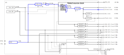

Gauri_n
I could see your configuration is using PE clock source as Oscillator clock. CAN communication is working for us when we are using Oscillator clock which takes the external oscillator frequency of 8MHz from S32K142 EVB
We are facing issue when using System clock as 80MHz(for Normal Run mode as per S32K142 reference manual example and PE clock source as Peripheral Clock. Also in the first screen shot you have provided, configuration for SPLL_CLK is 80MHz and System clock as 8MHz. But in our case System clock is 80MHz
Could you please check and let me know if there is any issue with configuring PE clock source as Peripheral clock?

Senlent
Hi@Gauri_n
I think this should still be a problem of clock configuration.
my configuration: RUN Mode
It works fine, but  i just tested 'receive' only.
If the problem is still not resolved, I can help you check your code.
BR!
Jim.

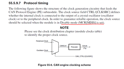

I checked again with the same bit timing values and clock configuration as you had given. I could find the issue. The issue is CTRL1[CLKSRC] is not set as 1 even though the clock source is configured as peripheral clock.
As I had mentioned in the previous message we are using EB Tresos tool for CAN driver configurations. In code from EB Tresos, CTRL1[CLKSRC] is being set with configured clock source after reset of MCR[MDIS] register due to which MCR[NOTRDY] is also reset. This seems to be an issue in EB Tresos code.
I understand CTRL1[CLKSRC] should be set before reset of MCR[MDIS]. Could you please let me know if this understanding correct? Is there any other conditions to be considered for setting CTRL1[CLKSRC]?
Thank you for your support

Senlent
Hi@Gauri_n
             I use your method to configure the clock module then IDE shows some errors.I think this question may be caused by your clock configuration error.
Below is my test and it works fine.
Hope this answer can help you.
