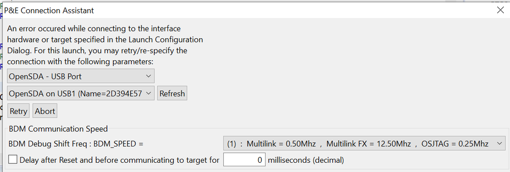

Hi ,
I am trying flash program in S32k146 using J-Link .In that case It shows "Target is Not connected"  when I am trying to flash by MBD , Design Studio & also .srec file.
Using OpenSDA it works fine.
In MBD:
In MBDIn MBD

Hi @PU1,
Just to be sure, do you connect the probe to the right JTAG/SWD port?
Can you update the SEGGER drivers?
Have you tried J-link commander?
BR, Daniel
