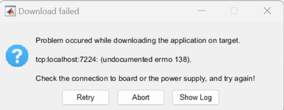

I am trying to flash the Target board with CAN examples from the MBDT toolbox.
But I get the following error.
I see that the MR-CANHUBK3 has no traditional openSDA port available.
How do I proceed with downloading the example on to the board if openSDA port is not available on the board?
Thanks for the help

Can I use S32 Debug Probe as the external debugger probe? (I already tried this though, I am getting the same error message I posted above when I was trying to flash)
Or should I use something like Segger J-Link EDU Mini- JTAG/SWD Debugger?
Thanks again for the help!

Hi@HariRam_111
S32 Debug Probe
From the picture above, you can see the S32K is not in the support list.
Here I recommend using Lauterbach, Pemicro Multilink, Segger-J-link.
"Segger J-Link EDU Mini- JTAG/SWD Debugger"
You need to check with Segger technical support as this is not a commonly used debugger

Hi@HariRam_111
You need an external debugger
