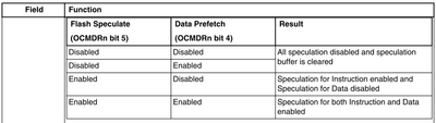

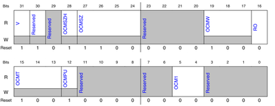

could you try to disable speculation buffer? It can be done in OCMDR0 register, OCM1 bit field:
lukaszadrapa_1-1621936320670.pnglukaszadrapa_1-1621936320670.pnglukaszadrapa_2-1621936345704.pnglukaszadrapa_2-1621936345704.pnglukaszadrapa_3-1621936356727.pnglukaszadrapa_3-1621936356727.png
Both bits are '0' (feature is enabled), try to set the bits to '1'.
Does it help?
