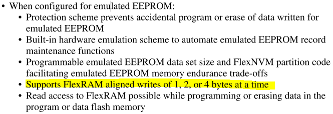

stabilo
Hello support team,
Can you please explain me how does the eeprom work on the S32K144 ? What are the differences between the eeprom data set (FlexRam) and the eeprom backup (FlexNVM) ? How to perform read and write operation ?
The datasheet does not give much informations about eeprom.
Thank you.
7,539 Views
lukaszadrapa
see the description of Program Partition command in reference manual. This command is intended to configure the EEPROM - it says how much data flash (FlexNVM) and how much RAM (FkexRAM) is used for EEPROM emulation.
If emulated EEPROM is used, you just read and write the FlexRAM. Internal mechanism will ensure that all data written to FlexRAM will be programmed (as a records) to data flash. After reset or power-on, internal controller goes through all records in data flash and copies them to FlexRAM. That means you will see valid data in FlexRAM after reset/power-on. Everything is done on background without user's intervention.
The emulated EEPROM is supposed to be used for data which are changed frequently. If you have "static" data (data which are changed only rarely in comparison with other data), it is good to store them in data flash which are not used for emulated EEPROM or in program flash. A lot of static data in emulated EEPROM leads to higher number of program/erase cycles due to clean-up mechanism of emulated EEPROM.
