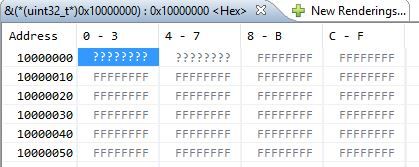

What do you see in the debugger's memory view?
8,691 Views
lohrsistemas
Hello Daniel,
Thanks for reply.
It happens again with your function to read the memory, exactly in this line: "data = *ptr;"
Here what I have in the memory:
And the problem happens when I read the address 0x10000000, the others it doesn't happen.

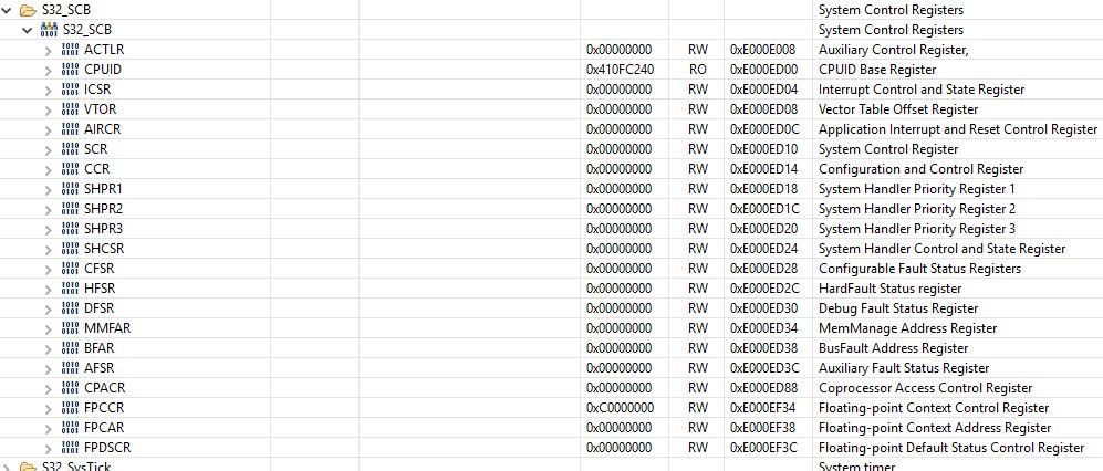

Here the register that you asked for:
What could be happening?
8,691 Views
danielmartynek
So there is no fault exception. Maybe double-bit ECC error indicated by FERSTAT[DFDIF] flag.
But it doesn't explain why there are the some data if you didn't write anything to the DFlash block.
Is there a problem erasing the DFlash block?

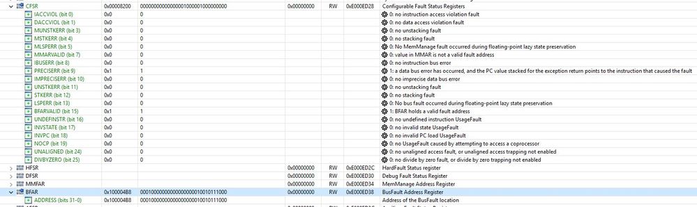

When the hard fault occurs, now I could get the important registers:
In the address that BFAR shows I have the "????" data:
I will implement your suggest about the BusFault Handler, but would be correct fix the problem that is causing "???" data.
Thanks.

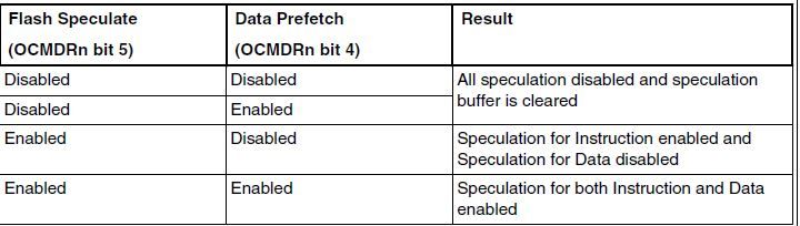

Thanks for reply. Taking a look in your observation I get this value to the MSCM_OCMDR1 register:
In RM 34.4.2.19.4 we have:
So is this value ok? "10" => "Speculation for instruction enabled and speculation for data disabled"?
Other question, what you suggest is this in the code:
MSCM->OCMDR[1] &= ~MSCM_OCMDR_OCM1_MASK; /* Disable buffer */
WriteFlashFunction();
MSCM->OCMDR[1] |= MSCM_OCMDR_OCM1_MASK; /* Enable buffer */
Best Regards.
8,691 Views
danielmartynek
The default MSCM->OCMDR[OCM1] value is 0b00.
That means: “Speculation for both instruction and data enabled”.
So, it’s the other way round:
MSCM->OCMDR[1] |= MSCM_OCMDR_OCM1_MASK; /* Disable buffer */
MSCM->OCMDR[1] &= ~MSCM_OCMDR_OCM1_MASK; /* Enable buffer */‍‍‍
