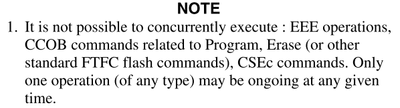

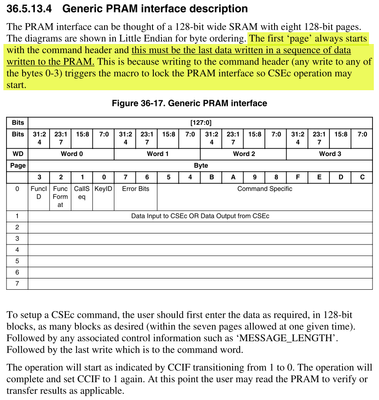

lukaszadrapa
Hi Phillip,
"And, I guess the CSEc command is launched by clearing CCIF flag."
No, it's not. It says indicating, not starting.
Take a look at:
Then:
And some example from AN5401 code:
Lukas

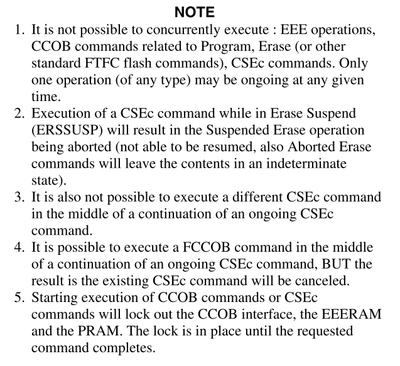

7,010 Views
lukaszadrapa
Hi Phillip,
I can see no problem here. It's mentioned in the notes that only one command can be executed at a time. Adding the screenshot again:
Anytime when you are going to launch a flash command or CSEc command, you should check (using CCIF) if previous operation is completed. This is done in the drivers, so it's safe.
Lukas
