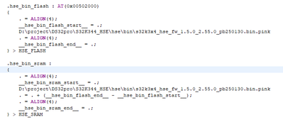

I'm trying to install HSE via MU interface in my S32K344 development board.
After reading lots of docs and files, i still have some questions.
1. I want to put pink-image in sram. I tried to use ld file to put image in sram directly,but it seems to fail. (Use ld file to put image in flash is OK)
HSE_FLASH : ORIGIN = 0x00502000, LENGTH = 0x00030000
HSE_SRAM : ORIGIN = 0x20410000, LENGTH = 0x00030000
As an alternative solution, now I disable MPU, and use memcpy to copy image to ram from flash, that works.

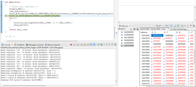

2. I use "Power_Ip_PerformReset(&Power_Ip_HwIPsConfigPB);" to call a functional reset.
when "Power_Ip_PerformReset"is triggered, content in sram lost,and go to the first line of main function. This seems not fit with docs,
Is my usage correct? Is this the normal behavior of a functional reset?
3. How to write and read  DCMRWP1 and MU Rx/tx register via app. I tried to use jlink in debug, but failed to read and write.

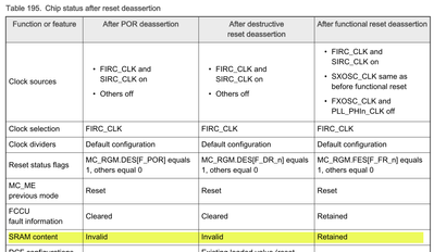

The RAM memory must be initialized:
This initialization is required after POR reset and after destructive reset when the RAM content is invalid. RAM content is retained across functional resets, so RAM initialization is not necessary in this case.
The "????????" in the debugger means that the debugger is not able to read the data. In case of RAM, it's due to ECC errors when the RAM has not been initialized.

The reason why content in sram is erased is found:
In .ld file, there's one configuration "__RAM_INIT = 0;" This lead to sram init every reset.
I don't have trace32, so I use Jlink. I tried to modify directly via debugger, but failed.
WARNING: Failed to read memory @ address 0x402AC2C0
WARNING: Failed to read memory @ address 0x402AC66F
