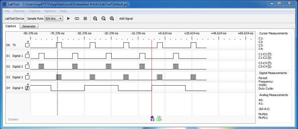

It is difficult to describe in text, you can refer to the pictures in Modulated PWM waveform Generation
The Original waveform of FTM0_CH0~FTM0_CH7 should be like D0 D1.
The modulated waveform of FTM0_CH0~FTM0_CH7  will be like D2 D3.
The high frequency 50% duty PWM is FTM1_CH1.

1. Is FTM2 generating a 50% duty modulated signal?
2. In the case of modulated frequency i.e, D2 & D3, how actually channel duty cycle is varied?
3. Is there anything we need to do via hardware so as use FTM2 for modulating frequency?

Let me try to add comment to your questions.
1. It generates a 50% duty cycle pwm output.  The FAULT input signal performs the modulation.
2. Same as usual for PWM functions.  MOD register is the period and CnV register is the duty.
3. Yes, you must hard wire the FTM0 outputs (ch0 and ch2) to the FTM1 and FTM2 FAULT input pins
