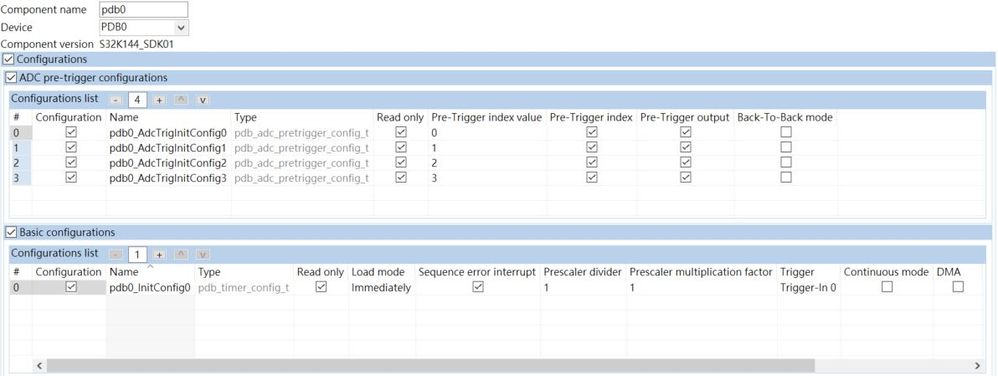

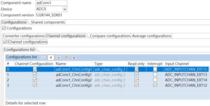

Hi, I'm developing a DC motor control project based on S32K148, and I basically follow the MTR-148 example code to write code. Now the problem is that adc interrupt randomly stopped after successful working few seconds or few minutes.
Since I use the FTM-PDB-ADC trigger sequence, I had tried to change PDB MOD, Delay time...etc, but the interrupt is acting the same, sometimes even not work since beginning. When I check the register after the interrupt stopped, the COCO flag of last ADC channel (which also is configured to generate interrupt) is not set, but the COCO flag before this channel had all set.
Do you have any idea to this problem? Or is there any reference could help to this problem?

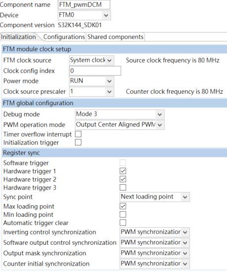

There's my initial settings below:
FTM with 80us,12.5kHz
TRGMUX:
PDB:
ADC:
Thank you very much!!

do you see some sequence error reported on PDB_CH0S?
Generally, be sure PDB pretriggers delays are properly set to be sure a conversion is finished between two petriggers. Also be sure ADC result registers are always read after conversion.
You can try to use DMA to read all result registers, trigger DMA from PDB using IDLY set for right time with respect of expected last conversion.
BR, Petr

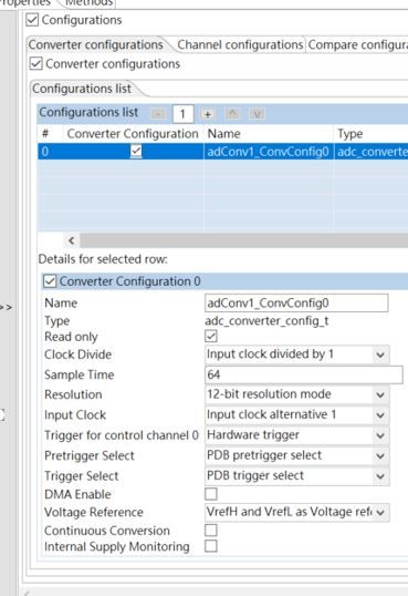

And I had tried to set DMA enable configuration for ADC module and add DMA channel for ADC0, it works fine until I enable UART0 through DMA. While UART0 is working ADC interrupt goes unstable again. Is this one of the issue?
Also you had mentioned " trigger DMA from PDB using IDLY ", is there more specific settings information I could know? For now I just simply configured ADC and DMA on Processor Expert tool, and PDB initial codes shows below:
Thank you !

I am not aware of the example for trigger DMA from PDB. Anyway you should do
- disable DMA from ADC and enable DMA from PDB within ADC and PDB components
- assign PDB as request to DMA channel in DMA component
- use PDB_SetValueForTimerInterrupt to configure IDLY register, to specify a time when DMA is
triggered
- configure DMA channel to read all ADC result registers upon single DMA request
BR, Petr
