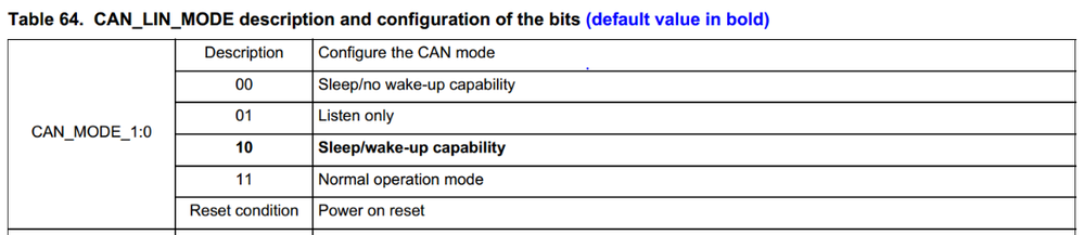

Hi,team
I am using FS6503, can communication can be normally used in debug mode, but can cannot communicate in operation mode. According to the operation manual, I configure CAN into operation mode, but I still can't find the problem, could you please give me some advice?
I configured CAN_LIN_MODE register, configure CAN_MODE_1:0 to "11",
the default CAN state is sleep;

Please take a closer look at our AN5238 where you can find the recommended start-up SPI sequence (Chapter 14.2). As you can notice, we use the 0xB0C0 command (CAN_MODE_1:0 = 0b11) to enable normal CAN operation mode after 7x good WD refresh (the 1st good WD refresh closes INIT_FS & the 7th good WD refresh clears the FLT_ERR_CNT)).
Keep in mind that the first watchdog refresh (0x4D when using a default LFSR value of 0xB2) must happen before INIT_FS timeout (256ms). Then you need to periodically refresh the watchdog during every open window of the window period (set using WD_WINDOW_3:0 bits). If you would not like to use watchdog, use WD disable (WD_WINDOW_3:0 = 0b0000) in INIT_FS phase (256 ms open window after releasing RSTB) and then close INIT_FS phase by 1 good WD refresh (0x4D when using a default LFSR value of 0xB2). Then no further watchdog refresh is necessary.
