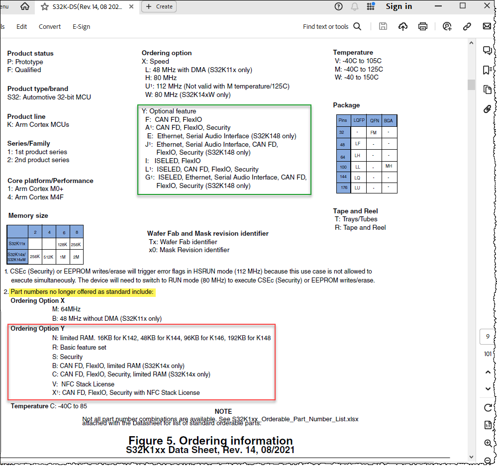

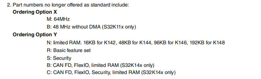

I want to know if there is any file can explain what the basic feature set means?
Thanks a lot

In short, there are no features listed in Y: Optional feature.
Y Optional feature R Basic feature set.pngY Optional feature R Basic feature set.png
The DataSheet mentions that Part numbers are no longer offered as standard include. I’m not sure if you can still order FS32K144HRT0MLLT?
