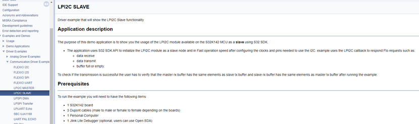

Part No : FS32K142UAT0VLFT (IC MCU 32BIT 256KB FLASH 48LQFP)
In application, the MCU planning to interface with main processor over I2C lines in slave mode. Does this MCU will support I2C lines in slave mode, please confirm.

Hi@gopalakrishna
The LPI2C module supports slave mode, and the LPI2C slave logic runs independently of the LPI2C master logic
if you already installed SDK like RTM x.x.x and you will find the demo "lpi2c_slave"
