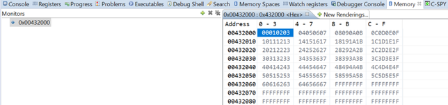

I use the RTD package to erase write and read the internal flash.It is success on data flash but when I change the address to code flash write and read are all failed .
And I debug and found the Register MCR->PGM has been changed to 1 after erase .But I cannot find where it was changed.Please refer to attach file for my source code.

Hi@tianxing
I spent some time testing your code,but I did not find the problem/
I have a successful example, as you can see it works well.
I will send it to you privately,please check it.

tianxing
And I found our source code is different,your source code cannot compile OK on my S32DS3.4.
The error message are as below:
D:/S32DS_WORKSPACE/S32K344_FLS/generate/include/Dma_Ip_Cfg_Defines.h:29:10: fatal error: StandardTypes.h: No such file or directory
29 | #include "StandardTypes.h"

And source code difference is as below:

Do you mean my code works well?
I use the  JLink V9 to debug ,Is it because this device mismatch S32K344?
And I cannot open you mex file
There is an error message
This version tool cannot support processor Platform_SDK_S32K3_2021_03
