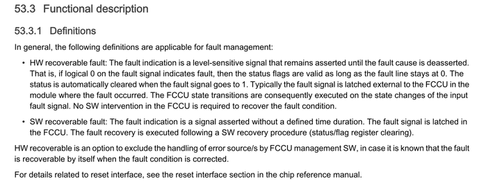

How can I determine fault recovery type while configuring FCCU? When should I choose software recovery and when to choose hardware recovery? Is there any specific failt examples?
158 Views
petervlna
Yes, you can refer to following from reference manual.
So the behavior on fault will depend on the needs of your application.
