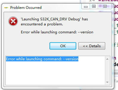

Error while launching command: --version
12,128 Views
anweichen
error.pngError while launching command: --version
9,576 Views
raresvasile
There is a known issue with PE micro debug plugins. You need to edit the debug configuration and add ${cross_prefix}gdb${cross_suffix} in the executable field of Debugger tab. See the picture below for the exact location.
