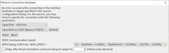

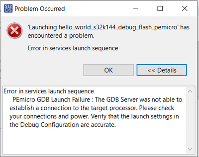

Hello Team,
I am using S32K144EVB and tried to run a sample application(hello_world_s32k118) with PE micro debugger (built-in OpenSDA) to check if the EVB is fine. Things were not going well and got errors as below.
Please provide the solution ASAP

It is working now, the issue is with the power supply. need to change J107 for USB supply
Thanks for the support.

Robin_Shen
Since you are using S32K144EVB, why do you want to run a sample application(hello_world_s32k118)? Please run the S32K144 example in the future.

Robin_Shen
Which example codes do you loaded into the device? Any for CSEc?
Did you secure the device?(FSEC SEC=secured )
Doesn't P&E Recovery Utility halt MCU? Please tell me what problem occurred during the operation.
