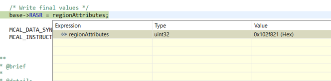

Hudson001
The issue disappeared after MPU init code masked, that means MPU disabled. So why the MPU would trigger the unaligned access issue? The MPU config is in below,
  Region  Description                   Start       End           Size[KB]  permission                attribute                 execute              srd     enable
       0  BACKGROUND_REGION             0x0         0xFFFFFFFF     4194304  MPU_ACCESS_P_PRIV_RW      MPU_ATTR_STR_ORD_DEV      MPU_INST_ACCESS_DIS  0x00    MPU_ENABLE
       1  CM7_SELF_ITCM_REGION          0x0         0x00007FFF          32  MPU_ACCESS_P_PRIV_RW      MPU_ATTR_NORM_MEM_WT      MPU_INST_ACCESS_EN   0x00    MPU_ENABLE
       2  PROGRAM_FLASH_REGION_ADDR     0x00400000  0x005FFFFF        2048  MPU_ACCESS_P_PRIV_RO      MPU_ATTR_NORM_MEM_WT      MPU_INST_ACCESS_EN   0x00    MPU_ENABLE
       3  DATA_FLASH_REGION_ADDR        0x10000000  0x1001FFFF         128  MPU_ACCESS_P_PRIV_RW      MPU_ATTR_NORM_MEM_WT      MPU_INST_ACCESS_DIS  0x00    MPU_ENABLE
       4  CM7_SELF_DTCM_REGION_ADDR     0x20000000  0x2000FFFF          64  MPU_ACCESS_P_PRIV_RW      MPU_ATTR_NORM_MEM_WT      MPU_INST_ACCESS_DIS  0x00    MPU_ENABLE
       5  SRAM_REGION_ADDR              0x20400000  0x20417FFF          96  MPU_ACCESS_P_PRIV_RW      MPU_ATTR_NORM_MEM_WT      MPU_INST_ACCESS_EN   0x00    MPU_ENABLE
       6  PERI_REGISTER_REGION_ADDR     0x40008000  0x40807FFF        8192  MPU_ACCESS_P_PRIV_RW      MPU_ATTR_SHR_DEV          MPU_INST_ACCESS_DIS  0x00    MPU_ENABLE
static const uint32 EcuM_Rbar[CPU_MPU_MEMORY_COUNT] = {0x00000000UL, 0x00000000UL, 0x00400000UL, 0x10000000UL, 0x20000000UL, 0x20400000UL, 0x40008000UL};
static const uint32 EcuM_Rasr[CPU_MPU_MEMORY_COUNT] = {0x1100003FUL, 0x0102001DUL, 0x05020029UL, 0x11020021UL, 0x1102001FUL, 0x0102F821UL, 0x1101002DUL};

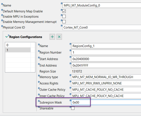

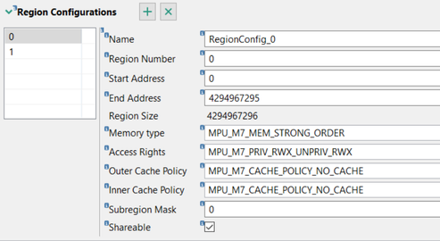

danielmartynek
I see, it is a normal type memory.
I have just reproduced the error using your RASR value.
In my test project, there are only 2 regions, this one and one that covers the whole map (Strongly ordered)
Why do you enable the subregions there?
It works when the subregions are disabled, refer to ARM documentation.
Can you try this configuration?
2,264 Views

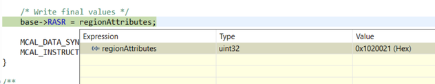

Hudson001
Hi Daniel, I got understand the RASR register usage.
The MPU region size (RASR.Size) is defined as 2^(16+1) = 128KB, so each subregion is 128K/8 = 16K. On S32K312, SRAM is 96KB, so SRD bit of RASR should be 0xC0, subregion 7,6 disabled, subregion 5-0 enabled.
I tested RASR with value of 0x01020021 and 0x0102C021, both worked, unaligned error did not happen on whole SRAM region of 0x20400000~0x20417FFF.
Thanks for your great support^^
