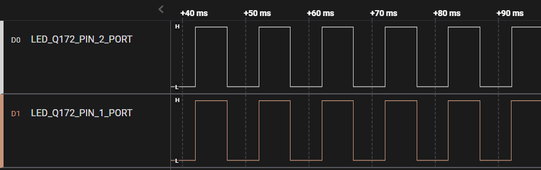

Senlent
Hi@Ayaz
I can't see how EMIOS triggers Bctu when used as Gpt, but I guess it is based on some flags or internal outputs
"To request an ADC conversion through the BCTU, a timer module such as eMIOS asserts its output signal, which is connected to a BCTU trigger input."
I hope you can read the data sheet later or write some test code yourself. This is the test routine I made for Gpt->Bctu->Adc. You can refer to it.
Trigger sequence
Adc result
