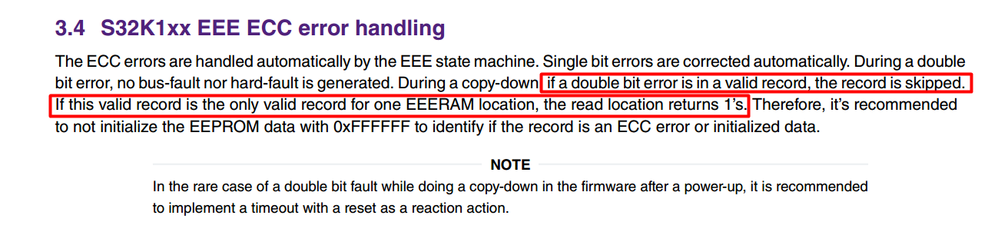

hello,
      what's the meaning of the Red box? when ECC check error  how does it feedback to users? Can you give me an example?pastedImage_3.png
wish your  help
 thank you

this is explained in AN11983:
https://www.nxp.com/docs/en/application-note/AN11983.pdf
You are not informed about that by a flag or by an exception, this needs to be handled on application level.

hello, as the description "The read location returns 1's ",  my understand is the follow
for example, if  the data  in  EEPROM address A  is 0x1010 1010, when read EEPROM address A by 32 bit width, if checked ECC 2bit error, the data in address A  is changed to 0xFFFF FFFF.
is  my understanding right??
thanks for your help!

Yes, that's correct.

hello Lukas,
         I can't understand this description as the follow red box,  could you describe clearly?

It is possible that there are more records in backup flash for one EEERAM location. For example, if you will write the same EEERAM location several times then new record is created for each write (this is simplified, of course, as there's clean up mechanism and so on...). If the latest one is corrupted, EEE engine will try to search for previous record. If it is available, this older record will be used.

thank you very much, I got it.
