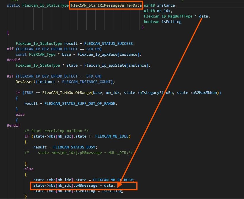

I met a problem that ECU will jump into Hard fault if ECU receive CAN frame in polling mode .
I take use of EB driver(SW32K3_S32M27x_RTD_R21-11_4.0.0_P04) and set Can_43_FLEXCAN_MainFunction_Read() in 10ms task.
 ECU would be easily jump into hard fault. if I send frame by CANOE cycle or manually.
if I put  Can_43_FLEXCAN_MainFunction_Read() in while(1), ECU can successfully receive CAN frame for a long time. but I can not sure ECU will not jump into hard fault for ever.

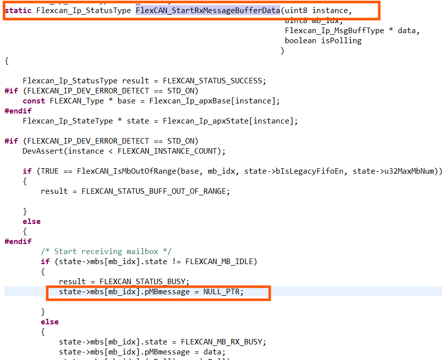

I try to
debug this problem and I suspect the function "FlexCAN_StartRxMessageBufferData" that each time ECU jump into trap the "else branch " can not be executed like the snapshot.
do you have any suggestion about this problem thank you .

yin_qiu

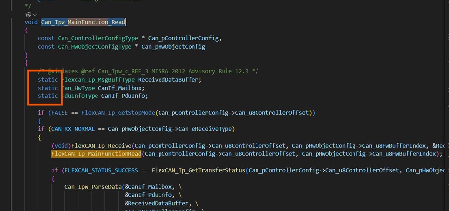

hello I take a reference of a Mcal code of previous version there is a "static" there. but there is no  "static" in SW32K3_S32M27x_RTD_R21-11_4.0.0_P04

Julián_AragónM
Hi @yin_qiu,
The static keyword was added in order to prevent multiple thread call overlap over the same variable in multi-threaded situations.

yin_qiu
I add a code here ,but I'm not sure it is correct.

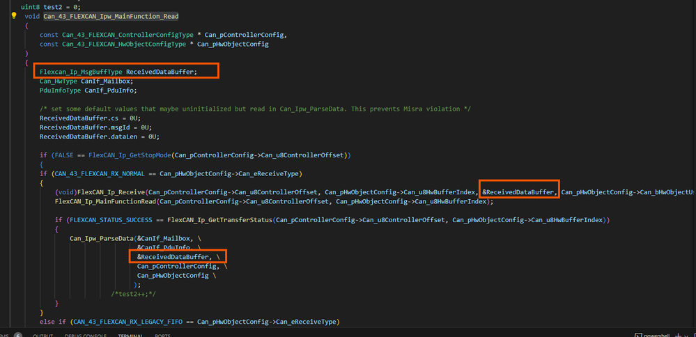

dear NXP experts:
I did some debug for this problem and I have some information to share and confirm with you.
pls check the picture below and you can see that the data (0x01~0x07)has been accepted by mailbox but the sdu address of upper layer is not share the same address with pMBmessage.
I debug the code and find that the pMBmessage is initialized by the code below:
if I set polling mode for CAN receive .the upper layer parse is done as the code below:
How can we guarantee the address of "ReceivedDataBuffer" is still keep the same as the initialized address of pMBmessage because the ReceivedDataBuffer is a local variable.
