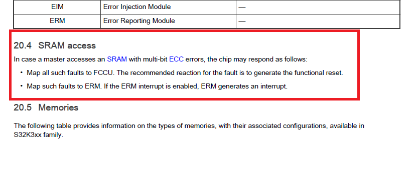

In RM rev 8 is written:
1)So, We enable FCCU reaction for unrecoverable ECC faults and we disabled ERM: SM1.DATA_ECC  seems to focus on FCCU usage ...
2) When we develop SRAM Fault injection, we take a look to example package S32K3_SAF_1.0.4_EVAL_D2312.exe. at the end of post follows  the Fault Injection snippets
We see that, after configuring and injecting fault to SRAM1 (EMCEM_EIM_CH_1) and triggering it by reading at 0x2024D000 SRAM1 address, an Hard Fault Exeption happens, we have checked on target this behaviour.
a) I Don't find the point on manual that describes this behaviour (Hard fault), can you tell me where is?
b) This hard fault exeption happens also with multibit ECC errors at runtime? Par 20.5 above talks about FCCU or ERM interrupt response and NOT of a hard fault exeption (due to a precise error on bus fault.) If yes how can it be compliant with a FCCU reaction. How should manage it ?
2) In SRAM(0,1) fault injection after eMcem_InjectFault(...SRAM_INJ_CH..), it is necessary to trigger process by reading from a SRAM address. For triggering  a DCACHE or ICACHE, after injecting into its fault channell what trigger should I use? I haven't any data address as a trigger, so how sould I trigger it?
3) In a S32k344 MCU in lockstep mode Should I trigger only CM0 Caches ? I suppose that in lockstep mode both CM0 and CM1 cores acts from/to the same memory space, isn't it?
Fabio

a) I Don't find the point on manual that describes this behavior (Hard fault), can you tell me where is?
This is described in core reference manual:
b) This hard fault exception happens also with multibit ECC errors at runtime? Par 20.5 above talks about FCCU or ERM interrupt response and NOT of a hard fault exception (due to a precise error on bus fault.) If yes how can it be compliant with a FCCU reaction. How should manage it ?
It be triggered on multibit ECC. I also expect you have some other cause for hard fault. Like reset escalation due to ECC. Make sure that you execute the ECC error injeciton only once and stop after reset. To prevent cyclic behavior.
Yes, as the ECC reporting is active on reads.
For triggering a DCACHE or ICACHE, after injecting into its fault channel what trigger should I use? I haven't any data address as a trigger, so how should I trigger it?
Any read on cache will trigger ECC if the is corrupt.
Good questions. I expect that only 1 would be enough, as if there is mismatch RCCU will be triggered.
Peter
