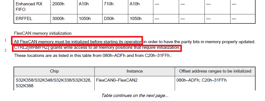

2) Anywhere another question is related to Reference manual rev8 page 2976
a) the initialization of all flexcan  memory address range and register (red-1) is done by FlexCAN_ip_Init() or must be done by user ?... I don't find any initialization in RTD and (red-2) I don't understand it, this bit should be set or reset, and what is the meaning of the statement?
3) is it necessary to call FlexCAN_Init() before fault injection process ?. It seems it is not necessary (and this would be a good thing for my software structure)

1)regarded point 2) of previous post, I checked too that FlexCAN_ClearRAM, called by FlexCAN_Init() clears a fewer part of the ram indicated in table "FlexCAN Error injection Map" par 73.1.2. p 2975 of RM rev8.
What does it mean that this, do I have to initialize all  uninitialized register manually by myself for fault injection?
2) In the project, I previous configured ECC error detection and correction for safety  punctual faults management, by calling FlexCAN_Ip_SetMemErrorDetection(..,true) function and and configuring ECC in Normal Mode. But again, I checked that:
So also in runtime detection/correction mechanism, memory(CAN_BASE_ADDR related) from 0x80-0xAD and 0xC20-0x31FF must be initializated.
But FlexCAN_Init() initialize a few part  of it.
So does aspect me that runtime Safety Mechanism  does not function properly (also without latent faults mechanism (falultInj) developed)?

yes, seems RTD is not fully correct with respect of ECC usage. This is disabled by default, i think, so does not bring any issue.
So before you want to enable ECC you need to manually initialize RAM from offsets 0x80-0xAD and 0xC20-0x31FF (or just parts does not covered by FlexCAN_ClearRAM).

I have a lot of problems to initialize it outside RTD, because, first you must enter in Freeze mode (and not sure if it is necessary to reset MCR[MDIS] or other stuff ), then clear CAN memory and finally (I think, disable freeze mode (and, maybe disable can....and probabilly some other stuff...)).
But happens to me that  sometimes MCU fails to enter in freeze mode and I don't know why .... and other  unpredictable behaviours.
Anyway in RM rev8  is reported as Follow (see point 3.):
So ALL flexcan memory is to be initialized only at step 3, after steps 1 and 2 !
FlexCAN_Init() follows exactly these steps and calls correctly  FlexCAN_ClearRAM() function. The problem (or bug?) is  that function  doesen't initialize all   0x80-0xAD and  0xC20-0x31FF (related to CAN_0) memory........... as requested by  R. manual.

not sure what to comment more. If ECC is enabled then all memory area specified must be written in Freeze mode to properly set ECC parity bits, otherwise after leaving Freeze module could not work properly depending on error detected.
However if you manually init all needed area, it would work then. FlexCAN_EnterFreezeMode_Privileged/FlexCAN_ExitFreezeMode_Privileged can be used to enter/leave Freeze mode.
