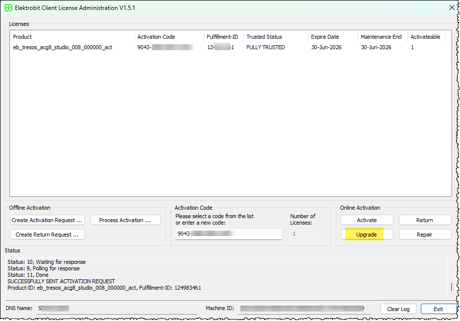

Robin_Shen
Here is the reply from Flexnet Help:
Now, our team is in the process of updating the activation code information in the system. It will be reflected soon, but until then, please use the new activation code provided below:
F5CF-8A53-B979-CD50
7,245件の閲覧回数
Robin_Shen
I cannot use this activation code for the time being: B25C-AEBB-4319-BAB1
I have reported this to my colleagues.
Do you have other activation codes that have expired in 2025?
If you used activation code expiring in 2025, then please hit the UPGRADE button in the EB Client License Administrator to extend the expiration date.

TomaZhang
I have the same problem, there is no other license could be upgrade.
Activating NodeLocked License B25C-AEBB-4319-BAB1, Number Of Licenses: 1
