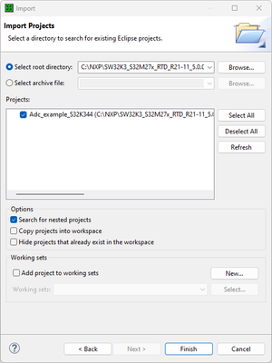

1. The RTD package includes some example modules for each driver. You can find them under your installation (by default: C:\NXP\SW32K3_S32M27x_RTD_R21-11_5.0.0). You can select "Import > General > Existing Projects into Workspace" and with the "Select root directory", add the path to the example you need, for example: "C:\NXP\SW32K3_S32M27x_RTD_R21-11_5.0.0\eclipse\plugins\Adc_TS_T40D34M50I0R0\examples\EBT\S32K3XX\Adc_example_S32K344"
