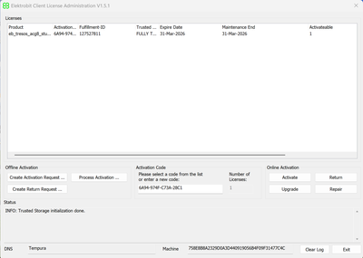

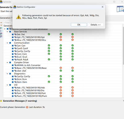

I was using the latest EB license, and everything worked fine recently. EB is still within the license period, but when I use Davanci to generate code, all the corresponding EB functions stop working, as if the license has expired. How can I fix this? I had also upgraded the license before this happened.

Hi @tempura,
Can you try the fix mentioned in this community post? Tresos79001: tresos_cmd.bat has returned the ExitCode 1 during Validation - NXP Community.

tempura
The problem occurred when I was adding the wdgM, wdg, and wdgif modules.

tempura
My EB license is 29.0, and my EB software version is 24.0.
