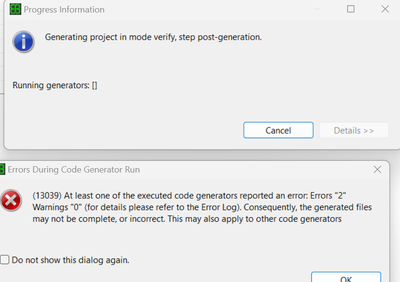

Hi Community,
I met an issue when I verifed the Mcal Configuration on EB,
On Error log view,
Does anybody have a clue about it?

Hi @focusdoit,
Is this an example from the RTD package? Could you share your version of the drivers and EB Tresos?

I just did a test on RTD SW32K3_S32M27x_RTD_R21-11_4.0.0_HF01.link,
Added Mcu module, verified, got warning 0, error 0, but when I added the DIO module , not configured it, then I try to verify the project, got
Do you know the reason? thanks

Resolved.

Perhaps it's RTD issue , tested again, ignore the Error log view, just generate the project, then 0 errors 0 warnigns, even the Error log view was clear. FYI. : )

focusdoit
I just did a RTD configuration test in EB,added 2 modules:MCU and DIO, removed the DIO, then 60002 error was gone.
