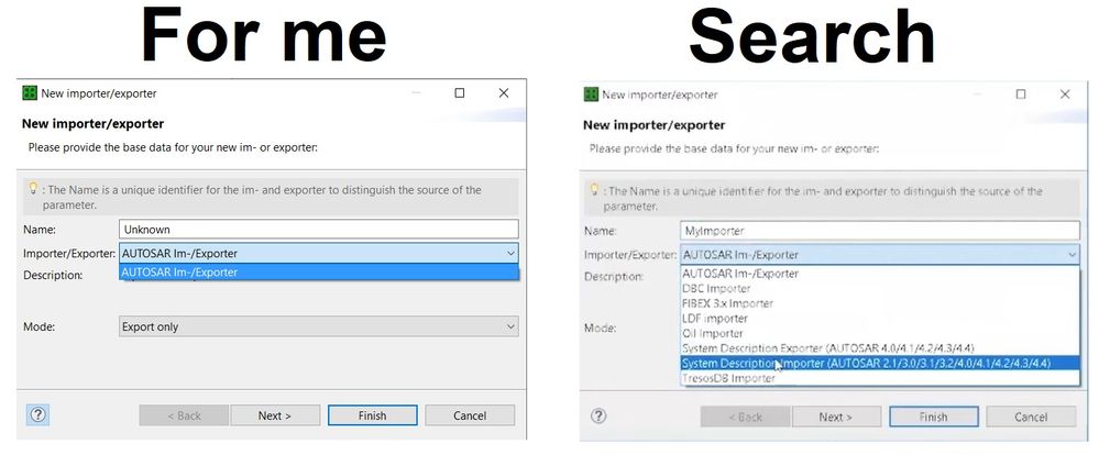

I have one more question now. I Activated EB Tresos version 28.0 (download evaluation version from electrobit websit) with license code on the address on nxp website but in my software when decided to import system description .arxml this table does not exist, do you know why?Untitled.jpg

Hello @Mizuz,
I guess it might be a type of software, as the evaluation EB 28 downloaded from Elektrobit has limited some features. You can ask Elektrobit for this: https://support.elektrobit.com/servicedesk/customer/portal/1/user/login?destination=portal%2F1

1. The EB Tresos 27.1 is available for customer orders the S32G/S32K Real Time products. You can consider to order one of them to get the EB Tresos 27.1
2. Auto-core feature is premium feature provided by Elektrobit, and none of EB Tresos versions provided in NXP website supports that feature.
3. System Description Importer feature is available on EB Tresos provides in NXP website, starts from EB 21.0. You can download EB tresos 21.0, or 25.1 in your list to try out.

hi @namnguyenviet I downloaded EB tresos 25.1 from the NXP website and licensing with an activation code on that address but when I run EB tresos, the System Description Importer feature is not available. are you sure about this feature is available on EB Tresos 25.1provides on NXP website? could you please check this on your system?

namnguyenviet
Ah, my bad! As I have rechecked, the license provided by NXP can't be used to activate the  System Description Importer feature. So you need to order the license from Elektrobit to activate that feature.
Sorry for this inconvenience.

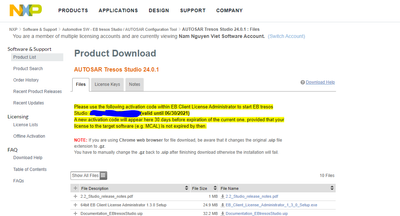

namnguyenviet
Hello @hua4_li
Which EB license are you using? You can check with this latest license: D4EE-792C-D616-6EB5 (valid until 12/31/2020)

namnguyenviet
The code can be found by access to your NXP account >> Software & Support >> Automotive SW - AUTOSAR MCAL / ISO 26262 >> Automotive SW - EB tresos Studio / AUTOSAR Configuration Tool, then click to the current TRESOS version you're using:

hua4_li
thanks,I used this code and solved the problem.
