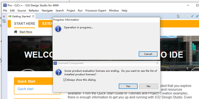

The running interface of S32DS keeps staying on this interface. After clicking "Cancel", the interface freezes. The software has been uninstalled and reinstalled already.

Usually S32DS need some time to install all plugins.
At bottom right there is a status bar for progress.

  Thank you for your patient explanation. I roughly know what you described. It's just that it could be used normally before. An unexpected error occurred during a debugging session, causing the software to crash and close. As a result, this situation appeared when I opened it the next time, and it has lasted for quite a while (it was still on this interface even after about an hour had passed). I don't think it's caused by downloading some kind of driver file.

I was talking to S32DS expert and he never saw this issue before.
We have also check your license and it is valid.
He recommends to:
Backup the content of folder : c:\ProgramData\FLEXnet\ folder (it is hidden)
And activate it again with original key : D5C7-DEBD-F83A-3F4A
