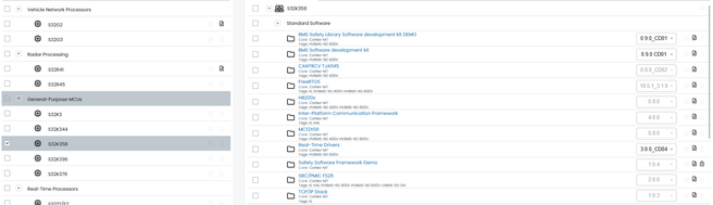

Shivanand
Hi @RafaR
Yes, I have installed the packages, but there is no reference to pressure sensor NPB8FD4T1 in the Packages. Can you look into it?

RafaR
Hi Shivanand
I have already done a thorough investigation, this is what I concluded and found:
The RD-K358BMU already has the NBP8-9x internally (the NBP8FD4T1 is from this family), so it is not usual that it needs an extra drive, it should already have the necessary software to work correctly, maybe there is a configuration problem I recommend you follow the following link:
https://www.nxp.com/design/design-center/development-boards-and-designs/sensor-developer-resources/s...
I recommend you download: Application Software for the Host MCU connected to the NBP8 – KE15Z FreeMASTER demo
But if you want to use an external sensor different from the internal one, download this: Application Software for the External MCU connected to the NBP9
