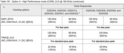

Hello everyone,
Could anyone clarify what is meant by "fast-pads" and "standard-plus pads" in the System Clock Configurations in the S32K3XX RM?

Hi @JRodrigues
This refers to the Pad type, which indicates the theoretical maximum output frequency and drive strength (not set, it is given for MCU pad). See the "S32K3xx_IO Signal Table" tab of the "S32K3xx_IOMUX.xlsx" file attached to the Reference Manual.
