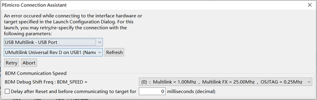

My NXP MCU is secure, how can I unsecure it?  My chip type is FS32K144HAT0MLHT
My operation process is as follows.
First, I downloaded the firmware by J-link, but it said my device is secure.
Then I want to verify what is the reason, so I tried to download the firmware by PEMciro and S32DS, but the S32DS said "Device is secure. Erase to unsecure? ". I clicked "Yes" twice, and it skipped to the PEmicro Connection Assistant window. It caused I couldn't debug or do any other things.
I tried 3 times by PEmicro and S32DS, the phenomenon is same.

Hi@Hanchun
please use j-link to read MDM-AP register to find why the device get locked.
you can follow this chinese article as below .
S32K1xx系列MCU应用指南之芯片锁死(lockup)复位原因分析与恢复方法详解
