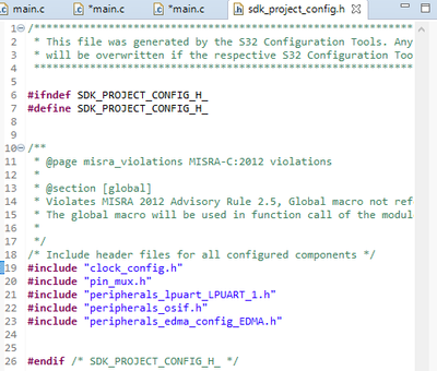

I have a problem with the library system in Design Studio (version 3.4).
I tested the lpuart_echo_s32k144 example with those includes:
I want to use parts of it in another project, but the first include can't be found there.
Opening the declaration of it shows, that it is just a group of included header files.
But if I try to include them its an "unresolved inclusion" again.
So I want and need to learn the general workflow with inclusions.
How do I find the librarys I need?

Hi Raphael,
The sdk_project_config.h shows: This file was generated by the S32 Configuration Tools. Any manual edits made to this file will be overwritten if the respective S32 Configuration Tools is used to update this file.
So you can direct "Editing a device configuration" for the new project or "Exporting a device configuration" from this old project.
S32DS_User_Guide can be found C:\NXP\S32DS.3.4\S32DS\help\pdf

I am new to microcontroller programming so I want to learn how the "usual" inclusion of libraries/header-files should be done, so I can program them by myself without those Tools. And the example files I tried so far used the S32 Configuration Tools.
So if we take this simple lpuart program as example, how can I recreate it without this Configuration Tools?
Can you recommend any Guides or Data sheets to learn this from scratch?
Btw. where can I find the Design Studio User Guide from your screenshot? Didn't find it online.

Just to give an example:
why are those "basic" librarys not callable?
and how do I get access to them?
