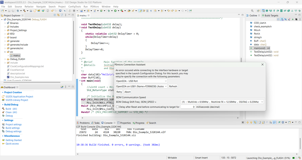

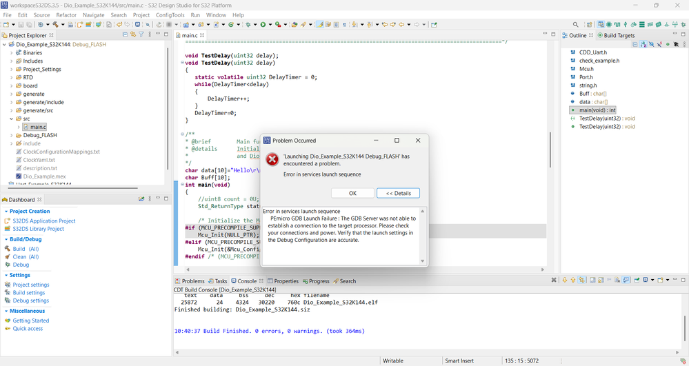

  I am using s32k144 eval board in that I am using PE-micro debugger (Open SDA FD906E5B) .when i am trying to debug/flash my code in the board and i am facing this issue. Could anybody let me know what is the issue and what mistake did i made.

Seems that you are configure Dio of MCAL.
Please make sure follow the "Under UnTouchedPortPin, click ‘+’ and add the following 5 PortPin Pcr numbers: 4, 5, 10, 68, 69" of HOWTO: Create a Blinking LED example project using S32K1xx RTD with AUTOSAR
These are debug pins.
If you haven't set them correctly, the debugger connection will be lost when the program reaches this point.
If this happens, try recovering using Kinetis_Recovery_Utility.zip.

Did the P&E Recovery Utility halt MCU?
How do you repeatedly power on and off the MCU?

It worked after using the kinetics recovery utlilty tool.
