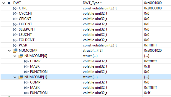

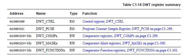

In ARMv6m there is no cyccnt, cpicnt, exccnt, sleepcnt, sucnt, foldcnt module. But since there is a 6word hole from CTRL address to PCS, I kept the ones from CM4.
According to ARM, there are n comp, mask and function modules, based on the value from CTRL. I could see that the CTRLval is 2 and not 4 like stated on the ref. manual.
And ARM does not specify a 32bit "hole" from the end of functionx to the start of compx+1. But I saw this on my debugger:
looks like there is "something" 32 bit from NUMCOMP[0].function to NUMCOMP[1].comp, hence I added the RESERVED in the NUMCOMP structure to have NUMCOMP1 aligned. .
Question1: Why there is an "hole" and what is there? Maybe I did not read correctly the ARMv6m architecture manual.
Second point: from debugger I can see the content of DWT->CTRL, but in the code
volatile uint32_t numcomp = DWT->CTRL;
returns 0.
Furthermore, writings from the CPU to the DWT do not update the DWT content (in any register), while writing in the expression tab with the debugger updates and correctly triggers the watchpoint.
Same issue with DEMCR register: writes from processor are ignored.

According to ARM, CYCCNT is not present in armv6. But stepping from the debugger, I can see the value of CYCCNT increasing:
etc.

1.
According to the ARM®v6-M Architecture Reference Manual, there is an unspecified gap between DWT_Function0 and DWT_Comp1.
0xE0001020 DWT_COMP0
0xE0001024 DWT_MASK0
0xE0001028 DWT_FUNCTION0
0xE0001032
0xE0001036 DWT_COMP1
0xE000103A DWT_MASK1
0xE000103E DWT_FUNCTION1
2.
The core does not have access to DWT on S32K11x (Cortex M0+), unfortunately.
