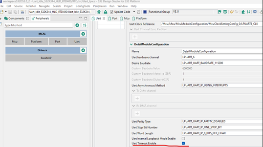

Hi NXP,
I want to use DMA receive to get the data received by DMA after generating idle interrupt, please tell me to implement, thank you.
Li 3
1,927 Views
dujunqiu
according to Uart_Idle_S32K344_LLD_RTD400.mex, not config lpuart DMA enable?

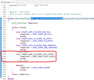

danielmartynek
Hi @li3,
LPUART_UART_IP_EVENT_IDLE_STATE is implemented in LPUART_Ip RTD 4.0.0.
But there is bug that will be fixed in the next release.
Hot fix:
Attached example uses the IDLE callback.
BR, Daniel
