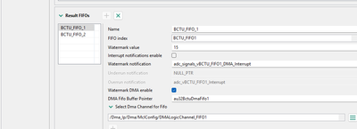

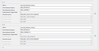

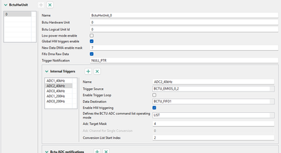

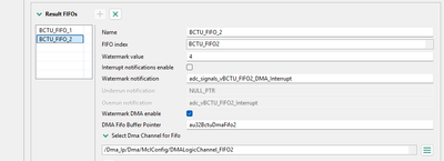

I am using DMA to transfer data from FIFO1 and FIFO2 into a buffer. I am utilizing fixed DMA configurations for this data transfer. when completion of the transfer, the following functions will be called:
  • Bctu_Ip_Bctu0Fifo1DmaComplete
  • Bctu_Ip_Bctu0Fifo2DmaComplete
The system functions correctly when I use an interrupt from RTD (IntCtrl_Ip_Init).
However, for my project, I am using a different file to configure the interrupt handler, set priority, and enable the handler.

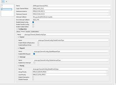

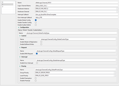

For DMA0_CH1 &DMA0_CH16,i am using IRQ :
DMATCD1_IRQn / Dma0_Ch1_IRQHandler / Priority
DMATCD16_IRQn / Dma0_Ch16_IRQHandler / Priority

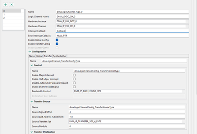

It works for BCTU_IRQn and PIT0_IRQn. It also works with DMA when it is triggered by PIT using the following configurations:
However, it does not show any indication if the transfer has begun or not, and it is not raising an interrupt when the transfer is completed for DMA while reading data from FIFO using the fixed RTD configuration setup for DMA transfer (Bctu_FifoSetupDma).
What additional configurations are needed to get the system working?

I have tested the system and identified Destination Bus Errors on channels 1 and 16.”
Do you have any idea about the cause of this ?
1,791 Views
PetrS
error may happen in case destination address points to memory range that is inaccessible - it means either access to reserved memory space or to disabled or un-clocked peripheral or protected by any kind of protection leading in bus error (MPU, XRDC).
BR, Petr
