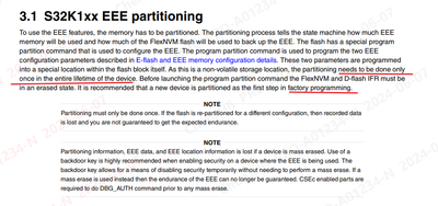

    I've executed the function
FLASH_DRV_DEFlashPartition(&gstFlashSSDCfg, 0x02u, 0x08u, 0x0u, false, true)
   but now,I want to modify my configuration to 32K eeprom,32k data flash in my product(#S32K144) without erase by J-Link.
  It seems that it can be modified by factory mode, who can give me more information or demo project
1,275 Views
lukaszadrapa
Hi @JinhuaiChen
It is not possible to update the partition without erase. The only option is to remove current partition by Erase All Blocks Unsecure command or by Erase All Blocks command (in this case, you need to update Flash configuration field appropriately by yourself). And then you can run the partition command again.
Lukas
