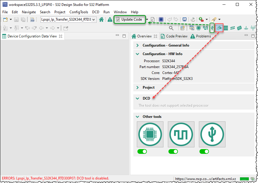

I try to compile an example project for S32K358, it says "DCD tool does not support selected processor. Select different tool."
Have I missed a tool setting or I do not need this DCD tool? the compile error says the *.h file can not be found.

Hi Gary,
You don't need DCD tool. Please select other tool, for example: Peripherals tool and then click Update Code.
DCD tool does not support selected processor. Select different tool..pngDCD tool does not support selected processor. Select different tool..png
