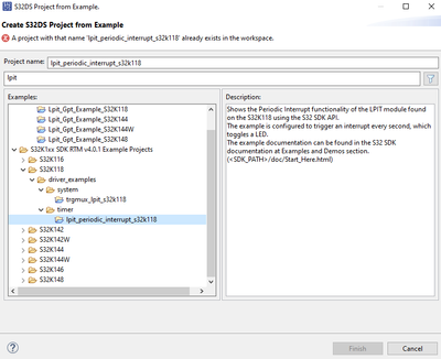

I am trying to debug to check whether isr has come up or not, while loop is executing once.but going to default isr.any suggestion how to check interrupt is running or not .

You can place a breakpoint inside your interrupt handler to confirm it is indeed running. For example, if you flash the lpit_periodic_interrupt_s32k118 example, you can place the breakpoint inside LPIT_ISR and confirm the isr is active:

You are using EB Tresos along with SW32K1_RTD, is this correct? If so, please take a look into the EB examples for the S32K118;
  • Ftm_Gpt_Example_S32K118
  • Gpt_example_S32K118
  • Lpit_Gpt_Example_S32K118
The Lpit_Gpt_Example_S32K118 application uses the IP layer functionality to trigger a timer interrupt. Notification function increase a count variable by 1 and toggle state pin LED on board.
Please try this example for the GPT Pit interruption.
