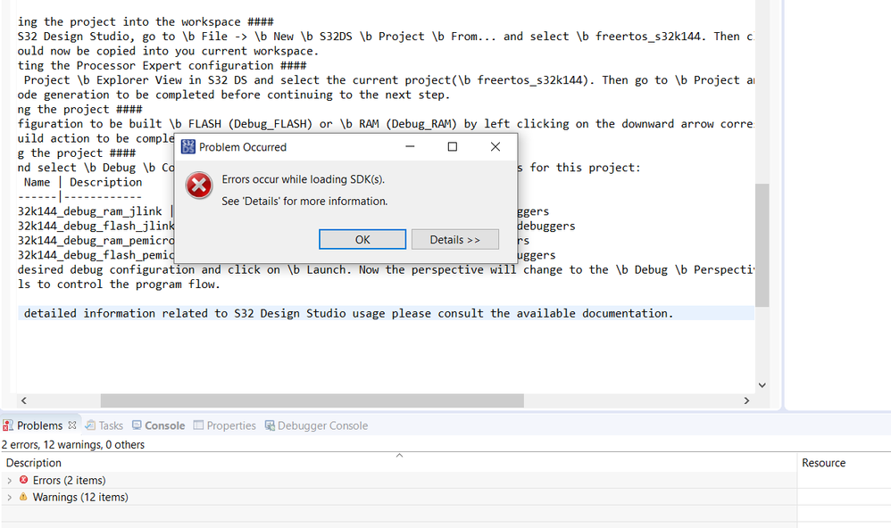

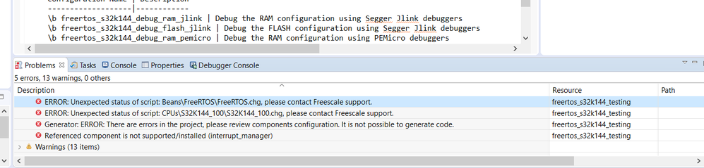

I am using S32K144EVB-Q100 board.
Create new project from example for freeRTOS.
But could not able to generate processor export code and build error.
Please check attached error messages for more clarification.

Now, this issue resolved by following below steps:
  • Uninstall/remove apps(IDE)
  • Delete NXP->S32DS_ARM_v2.2 folder
  • Delete workspace folder
Then re-install IDE, and followed same steps to create a project from example
Now, its working fine

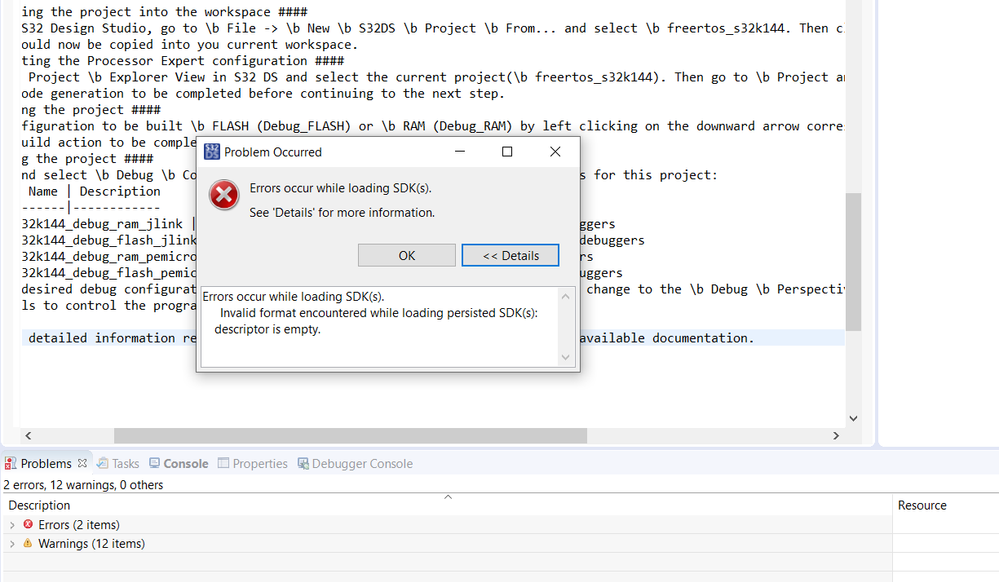

I am using S32 design studio for ARM (version 2.2) IDE
And followed below steps:
  • Click on file-->new-->S32 DS Project From Example-->S32SDK S32K1xx.....-->S32K144-->demo_apps-->freertos_s32k144-->finish
  • Then go to Project and click on Generate Processor Expert Code
But it could not able to generate-code due to error (previous attachment).
I also observe one error on IDE launch, please check attachment for more details
