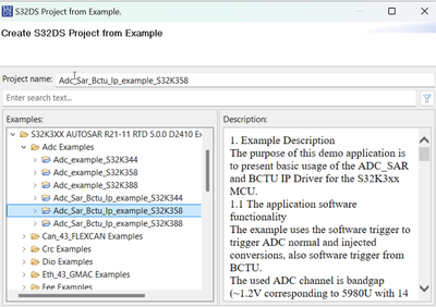

hi, I am currently working on contactor feedback through ADC with software triggering but i the ADC is being either in IDLE or BUSY state, Also i am not sure about the complete configuration changes in the adc and related peripherals , due to some configurations i am getting hard fault. although i have added CDD_m3hhb_adc_exernal_access.h/.c file in the build as well as well as the adc related driver files,  if any body has any reference or example code do, help

S32k358 microcontroller and LiFePO4 battery pack

Hi again,
For ADC SW triggering you could refer directly to RTD examples:
On the other hand, there is the following community post witch cover more software and hardware triggering methods:
https://community.nxp.com/t5/S32K-Knowledge-Base/RTD400-LLD-K344-ADC-SW-HW-trigger/ta-p/1966179
