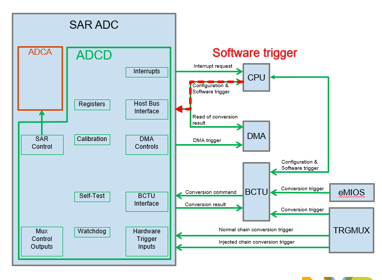

It is mainly divided into 5 parts:
(1) SW+ADC: software trigger, by adding timer PIT, the software trigger ADC is called regularly to complete channel sampling, and the collected value is printed out through UART printf.
(2) SW+BCTU+ADC: software trigger, by adding timer PIT, the software trigger BTCU is called regularly to complete ADC channel sampling, and the collected value is printed out through UART printf.
(3) PIT+TRIGMUX+ADC: hardware trigger, connect PIT to ADC through TRIGMUX, trigger ADC channel sampling through PIT hardware, and print the conversion value after the sampling conversion is completed.
(4) EMIOS+BCTUHW+ADC: hardware trigger, through EMIOS timing trigger BCTU to complete the corresponding ADC single channel sampling, due to the high sampling rate, only the BCTU sampling value is printed regularly.
(5) EMIOS+BCTUHWLIST+ADC: hardware trigger, through EMIOS timing trigger BCTU to complete ADC list channel sampling, due to the high sampling rate, the list channel value sampled by BCTU is printed regularly.

2.2 SW+ADC software trigger
    In fact, the original ADC demo of RTD400 already has ADC software and BCTU software trigger. This article adds PIT timing software trigger based on this function, and prints it out through UART printf, making it more convenient to check the ADC test value through serial port printing.
The block diagram structure of the software triggering ADC in this article is as follows:
Fig 2

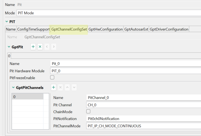

Pit: Used to generate 1S timing, the main configuration is as follows:
Fig 5
Fig 6

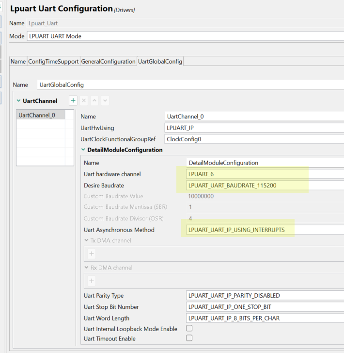

Lpuart_Uart:
Fig 7

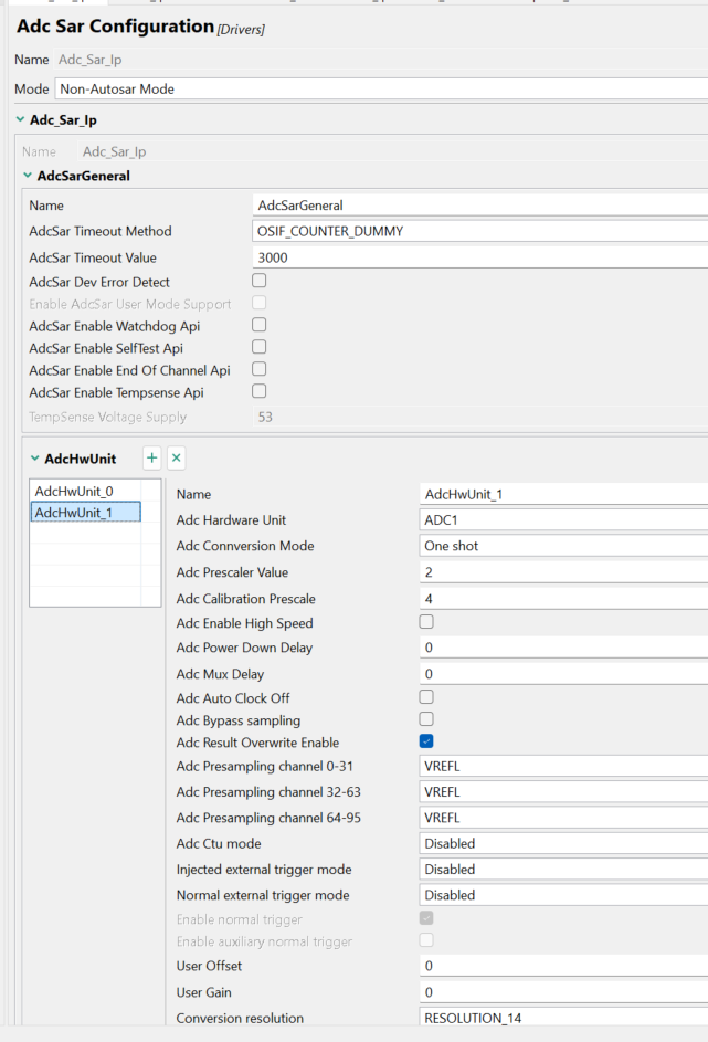

Adc_Sar_Ip:
Fig 8
Fig 9

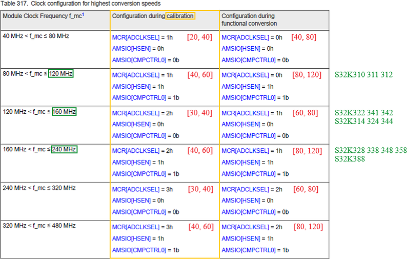

It should be noted here that ADC calibration prescale and Adc prescaler vale need to meet the following conditions, which can be found on S32K3RM:
Fig 10
Since the clock source of ADC1 is 160MHz, the calibration division is configured as 4 and the conversion division is configured as 2.

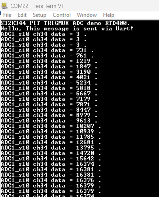

The test results are printed as follows:
Fig 12

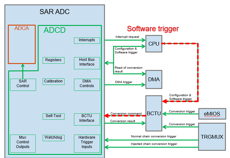

2.3 SW+BCTU+ADC Software trigger BCTU
Based on SW+ADC trigger, add BCTU, and use BCTU software trigger to complete ADC sampling. The block diagram structure is as follows:
Fig 13

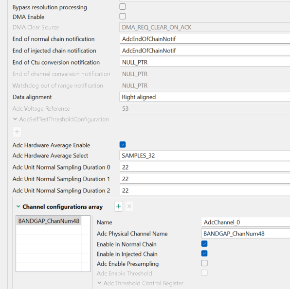

Here we can see that in Figure 14, the adc ctu mode is: trigger mode.
Add the Bctu_Ip module and configure it as follows:
Fig 16

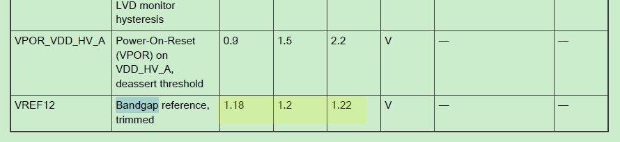

The corresponding selected BCTU channel is 48, which corresponds to the internal bandgap module.
Fig 17
The typical value is 1.2V, so the reference voltage is 5V, and the corresponding 14-bit ADC bandgap expected value is:
(2^14)*1.2/5=3932 around.

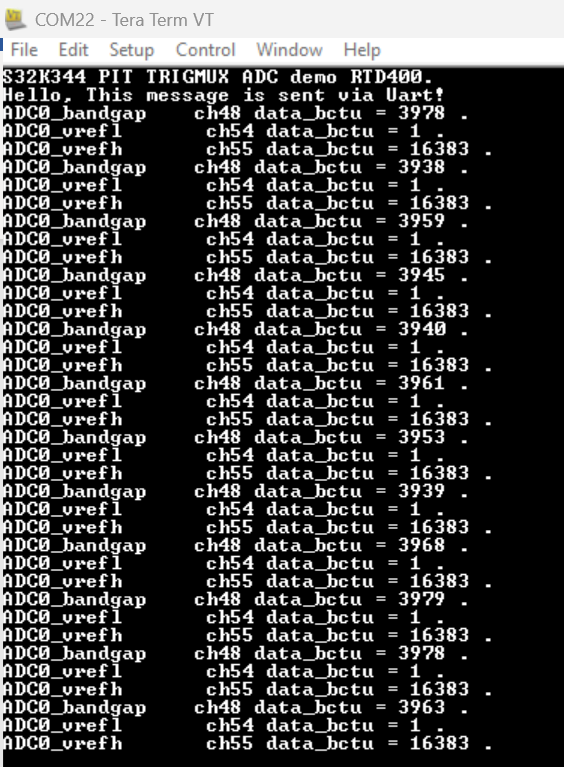

void BctuWatermarkNotif(void)
    uint8 idx;
    notif_triggered = TRUE;
    for (idx = 0u; idx < BCTU_FIFO_WATERMARK; idx++)
    	data_bctu = Bctu_Ip_GetFifoData(BCTUHWUNIT_0_BOARD_INITPERIPHERALS_INSTANCE, BCTU_USED_FIFO_IDX);

    	  Bctu_Ip_SwTriggerConversion(BCTUHWUNIT_0_BOARD_INITPERIPHERALS_INSTANCE, BCTU_USED_SINGLE_TRIG_IDX);
    	  while (notif_triggered != TRUE);
    	  notif_triggered = FALSE;
    	  printf("ADC0_bandgap ch48 data_bctu = %d .\r\n", data_bctu);
Test result:
Fig 18
It is close to the typical expected value, indicating that it has been successfully run.

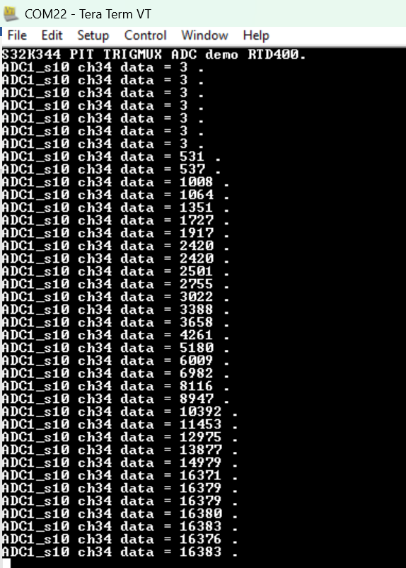

In While(1), we can see that there is no software-triggered call. We can directly check the ADC1 conversion completion flag and then print the data. The test results are as follows:
Fig 21
It can be seen that as the external potentiometer changes, the sampled value of ADC1_S10 also changes.
Used demo:S32K344_PIT_TRIGMUX_ADC_printf_RTD400.zip

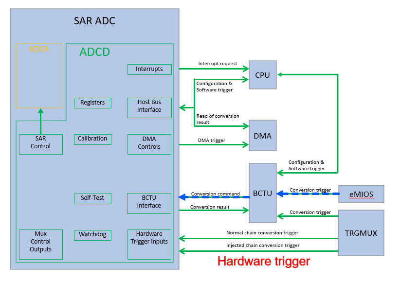

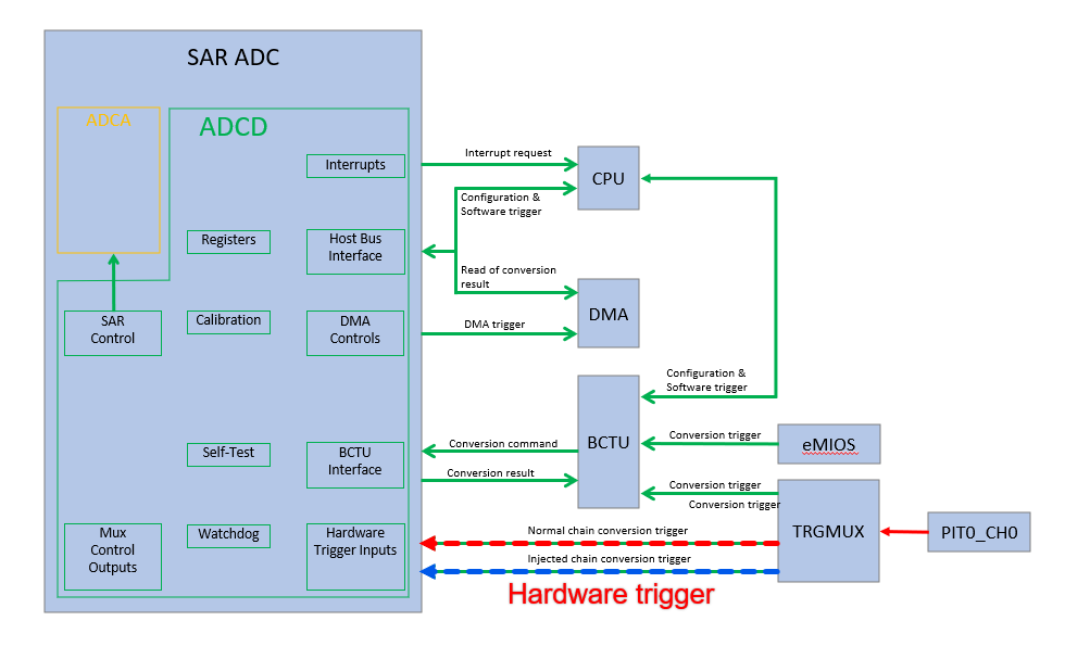

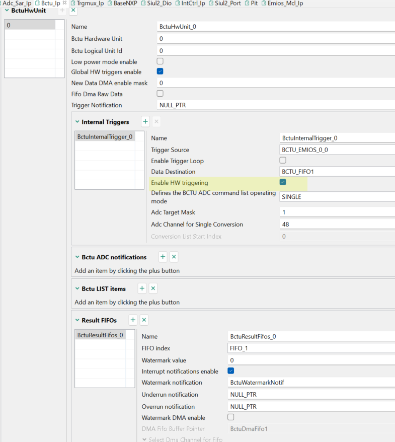

2.5 EMIOS+BCTUHW+ADC hardware EMIOS BCTU trigger
The block diagram structure of this section is as follows:
Fig 22
Use eMIOS0_CH0 to generate a 10Khz clock to trigger BCTU to complete the sampling of ADC0_48 channel, that is, bandgap.
In the CT tool, add Emios_Mcal_Ip and configure it as follows:
Fig 23
Change the BCTU configuration to enable HW triggering. The configuration is as follows:
Fig 24
Main code related codes are as follows:
Emios_Mcl_Ip_Init(EMIOS_INST0, &Emios_Mcl_Ip_0_Config_BOARD_INITPERIPHERALS);
    while(1)
      if( toggleLed == 1)
    	  toggleLed = 0;
Since the sampling rate is triggered at a frequency of 10Khz, the frequency is relatively fast, so the printing here is still based on 1s. The printing results are as follows:
Fig 25
As you can see, the result is also a variable bandgap value.
Used demo:S32K344_PIT_TRIGMUX_BCTUHW_EMIOS_ADC_printf_RTD400.zip

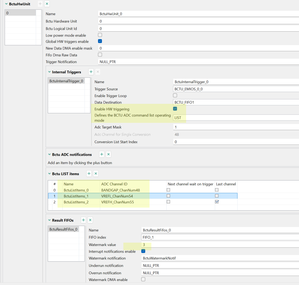

2.6 EMIOS+BCTUHW LIST+ADC hardware EMIOS BCTU trigger LIST
This section is similar to the EMIOS BCTU hardware trigger above, except that the BCTU is configured in the form of LIST, which can trigger the conversion of multiple channels at once. The main modifications are in the BCTU module:
Fig 26
Add the corresponding main code as follows:
#define BCTU_FIFO_WATERMARK             3U
    uint8 idx;
    	data_bctu[idx] = Bctu_Ip_GetFifoData(BCTUHWUNIT_0_BOARD_INITPERIPHERALS_INSTANCE, BCTU_USED_FIFO_IDX);
    while(1)
      if( toggleLed == 1)
    	  toggleLed = 0;
    	  printf("ADC0_bandgap    ch48 data_bctu = %d .\r\n", data_bctu[0]);
    	  printf("ADC0_vrefl       ch54 data_bctu = %d .\r\n", data_bctu[1]);
    	  printf("ADC0_vrefh       ch55 data_bctu = %d .\r\n", data_bctu[2]);
Test result is:
Fig 27
It can be seen that the results are consistent with the collected bandgap, VREFL, and VREFH, indicating that the code function is running normally.
