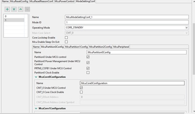

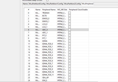

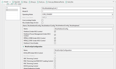

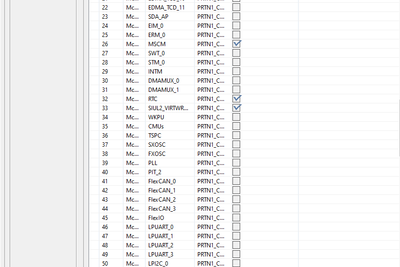

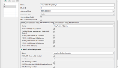

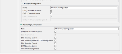

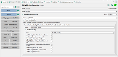

 I am working on an 2Wheeler Ev project that will be operating NXP S32K322 Cortex_M7_0.
I am trying to implement power saving feature for the project.
Now one difficulty I am facing to reduce current in uA , currently the current consumption
is around 6-9mA when configured Core standby mode with below configuration.
AbdNxp_6-1732795409691.pngAbdNxp_6-1732795409691.pngAbdNxp_7-1732795431599.pngAbdNxp_7-1732795431599.png
AbdNxp_0-1732795101657.pngAbdNxp_0-1732795101657.pngAbdNxp_1-1732795129607.pngAbdNxp_1-1732795129607.pngAbdNxp_2-1732795166524.pngAbdNxp_2-1732795166524.pngAbdNxp_3-1732795200557.pngAbdNxp_3-1732795200557.pngAbdNxp_4-1732795215142.pngAbdNxp_4-1732795215142.png

Hi @AbdNxp,
Please refer to Table 15. STANDBY mode supply currents from the S32K3 Data Sheet, as well as the S32K Power Estimation Tool (PET) for an initial reference on current consumption.
Also, current consumption is based on the MCU, not the whole board. Are there any output pins that can drive an external load? If there are any input pins, can you try disabling the input buffer of the pins? You can also try to disable Pad Keeping.
