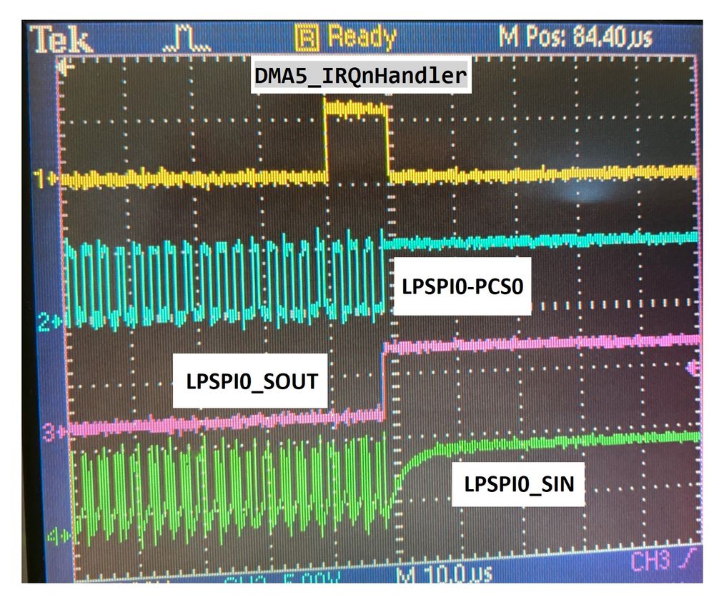

I am trying to connect an 18-bit SPI ADC to the S32K144(W) for continuous sampling between 40 kSPS up to 400kSPS. For that speed, I need DMA data collection. I implemented it with two Rx buffers.
The DMA TX Data Ready Interrupt occurred when the last 4 bytes were loaded to the SPI TX buffer, as seen in Figure 1.IRQ_0.jpgIRQ_0.jpg
The "LPSPI_DRV_MasterTransfer" instruction does not affect if the transmission is in progress.
To overcome this future of "LPSPI_DRV_MasterTransfer" I introduced some delay. Figure 2 shows a delay that is not long enough.
Figure 3 shows a "continuous transmission but with gaps between the packages. The gaps are 15.2 us long. The packages are 256 bytes long, which correspond to 64 ADC samples.
The measured signal is a communication signal, and the gaps are not acceptable.
What is the solution?
Continuous SPI with 15.2 us gap.Continuous SPI with 15.2 us gap.

instead of fixed delay you can try to call LPSPI_DRV_MasterGetTransferStatus function in loop to know driver is ready to call new LPSPI_DRV_MasterTransfer.
However the additional delay you see can be simply due to driver overhead, you can refer to its code.
You can try to use some nonSDk code, e.g. https://community.nxp.com/t5/S32K-Knowledge-Base/Example-S32K144-LPIT-DMA-LPSPI/ta-p/1108628, but you need to tailor it for your needs.
